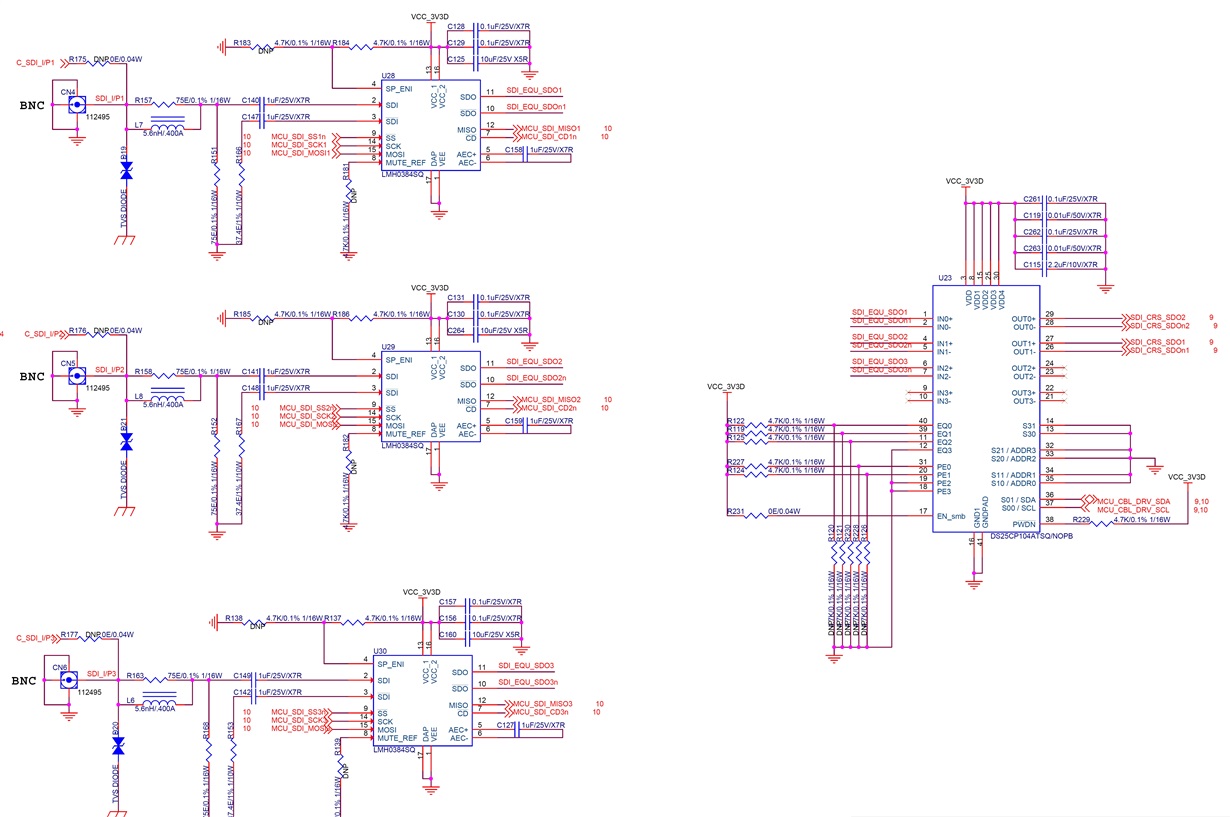

We are writing this mail as we are facing video detection issue with 3G-SDI, would like to have support on the same.
The setup as shown in the below block diagram:
- Input Source: DVD player or Media player
- Cable Equalizer: LMH0384
- Cross point switch: DS25CP104A
- Reclocker: LMH0346
- Cable Driver: LMH0303
- BNC cable: 75ohm impedance
Scenario1:Working condition
- I/P SOURCE :Reliance DVD Player.
- Setup is able to detect 1080p 50/60Hz
Scenario2:Not working
- I/P SOURCE :Amkette HD TV Player.
- Setup is working properly till 1080i 60Hz,
- With 1080p 50Hz and AEC settings in cable equalizer,able to see detection of video input for 3-4 secs after that it goes blank.
- Direct connection of the media player with PC Capture card its working properly with all resolutions.
I have attached screenshots of Custom board schematics for reference.
