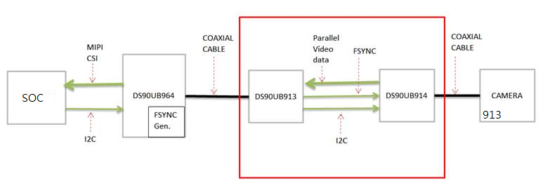

Dear Sir
Due to our target length is about 25m
So I would like to do a repeater of 913 and 914
Below is our system diagram ,could you kindly this application is workable or not?

Hi Kai,
In theory this setup should work however in practice I believe the BCC latency will make it unworkable. So unfortunately I doubt you would be successful with this kind of implementation.
