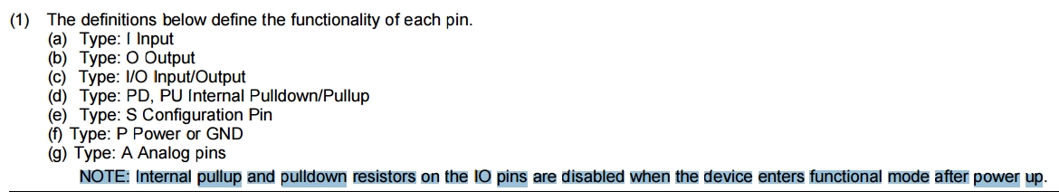

On the datasheet , it is mentioned that the MDC has internal pulldown resistor.
Also there is mentioned as the following,
How much is the pulldown resistor?

Hi Koji,
The internal pull-down resistance is 9k ohm.
