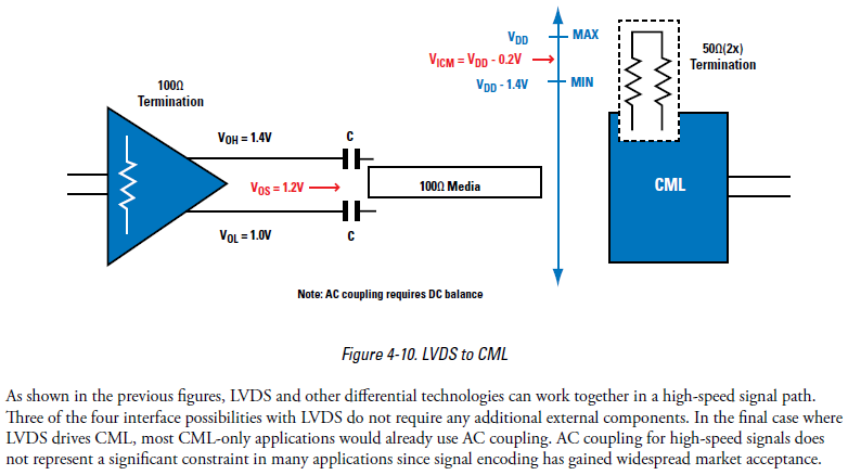

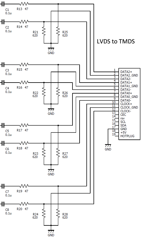

I'm working on a video card that allows the FPGA send data through HDMI.
The FPGA has true LVDS outputs.
As you can see in the following picture, what I'm trying to implement with your component is in the red rectangle
I can do it as the following diagram (with resistors and capacitors)
but as I found, I can implemented by using a AC coupling. There is one component that help me to do this?
