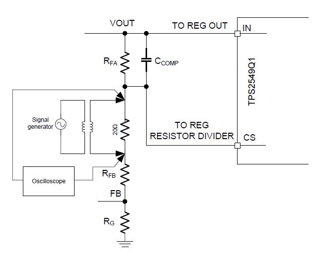

We got a question from customer about TPS2549-Q1.
Could you help us?
[Question]
How is the way to measure phase margin of DC/DC? I would like to make sure right connection to FRA. There is Loop pin(TP9) on EVM(-729). Is the below figure right?
