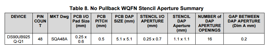

Please see Table 8. No Pullback WQFN Stencil Aperture Summary in Data Sheet P48.
Which dimensions in Figure 29 do these items represent?
