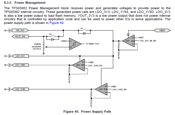

When I confirmed the power consumption of each power mode, I got the measurement result as follows;
ACTIVE mode = 5.94mA (Spec = 5.64mA
IDEL mode = 2.82mA (Spec = 1.66mA
SLEEP mode = 0.37mA (Spec = 0.058mA)
The below is the condition of measurement.
- Installed file = TPS65982_HD3SS460_DRP_Host_Full_2_15.tpl
- EVM
Power consumption is the current flowing to System_3V3 from DC power supply
Why is my measurement current higher than the specification?
Please teach me the correct measurement method and condition.
