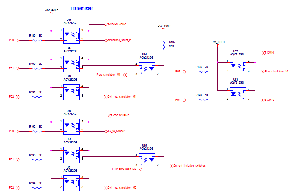

  • Hi Max,
    So we don't have the pull up resisters. Below is circuit diagram for your reference
    Its application circuit diagram
    Let us know your comments
    Thanks in advance
    Nitesh
  • Nitesh,
    Thanks for the schematic. Are you measuring the output voltage directly at the TCA6424A or at the photo-relay? The reason I ask is that the LED in the relay has a forward voltage of about 1.1 V, so it would make sense to measure 3.9 V there whenever it is "on" (i.e., TCA6424A driving low). If you are definitely measuring the TCA6424A output, could you please double-check the resistances R189-R194 to make sure they are 3 kOhm as shown?
