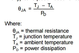

  • Hello Francis,
    thanks for your kind answer.
    I found below equation from datasheet.
    so, I understood about thermal data of TCA6424ARGJR as below.
    -      Max TA : 85c
    -      Calculated Max Tj = Max TA * (θJA*PD)
    -      Calculated Max Tj < Max TA
     Am I right?
    Also, I need one more information - Tc.
    Would you share the Tc(Case Temperature) of TCA6424A ?
    -TS

  • Hello TS,
    The case temperature of the device is to be measured along with the power dissipations (Pd) in the part. Once you have that information, then you can calculate the Tj of the part given the thermal resistance from case to junction. We specify the part operation of Ta, but it is referenced to a JEDEC standard. Our parts are simulated at 85C but technically our characterization data defines our guaranteed specifications. NOTE: characterization is done with minimal power dissipation so there will be a small temperature differential.
    Francis Houde

  • Hello TS,
    I already showed you the theta and phi parameters in the previous post in a table.  Tcase max isn't something we specify because this is a measured quantity.  Tjunction has to be extrapolated from the thermal resistances, the power dissipated, and the temperature of either air or case based on what you measure.  It must be calculated based on use case.  I am sorry, but I don't really understand what you need clarification with?
    Here is a link to an app note specifying IC thermal metrics and how to use them:
    http://www.ti.com/lit/an/spra953c/spra953c.pdf
    http://www.ti.com/lit/an/slrr012/slrr012.pdf
    http://www.ti.com/lit/an/snva183b/snva183b.pdf
    Let me know what I can do to help clarify.
    -Francis Houde
