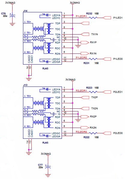

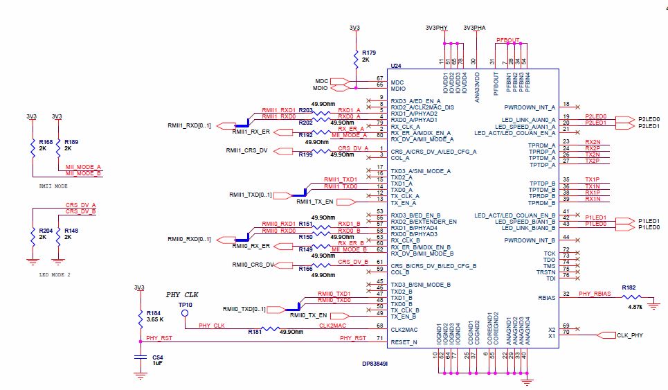

The part works fine except one issue.
LED_LINK_A/AN0_A and LED_LINK_B/AN0_B once in a while detect wrong polarity and would be OFF when the LINK is established and shortly blink ON on activity. When the cable is disconnected the LED would be ON. With s/w or h/w reset or power cycle it usually is back to normal.
The pins are connected to LED, 150 Ohm Resistor to VCC 3.3VDC. Datasheet shows 165 Ohm but 150  should be even better for the right polarity detection.
Any suggestions?
