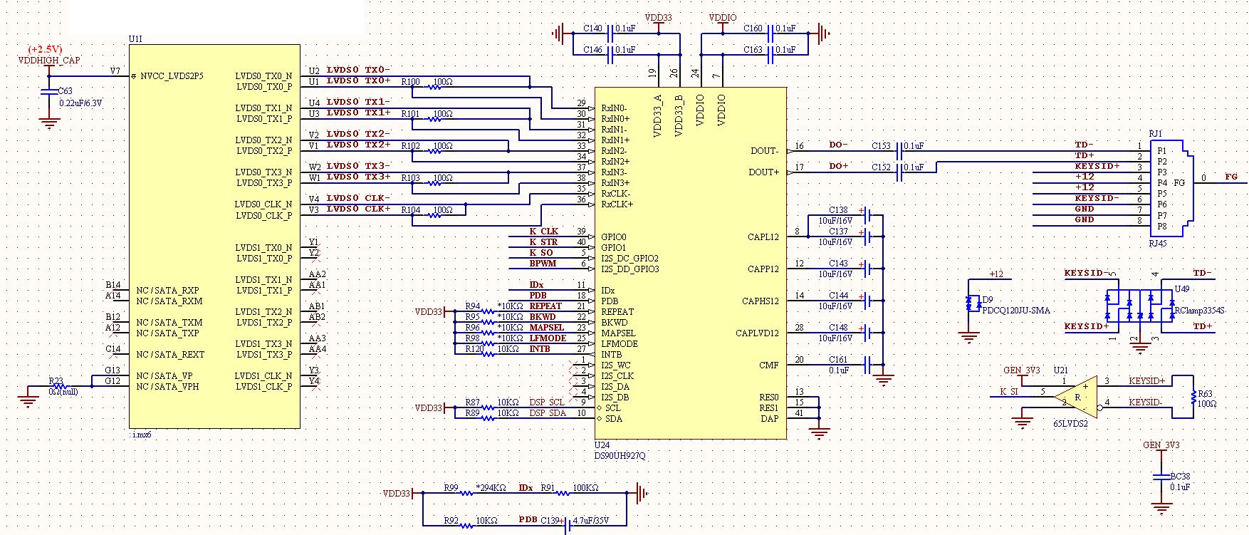

(a)The hardware configure of DS90UB927(TX).
Repeat=low
BKWD=low
MAPSEL=low
LFMODE=low
LVDS_CLK=65MHz
DS90UB927 schematic

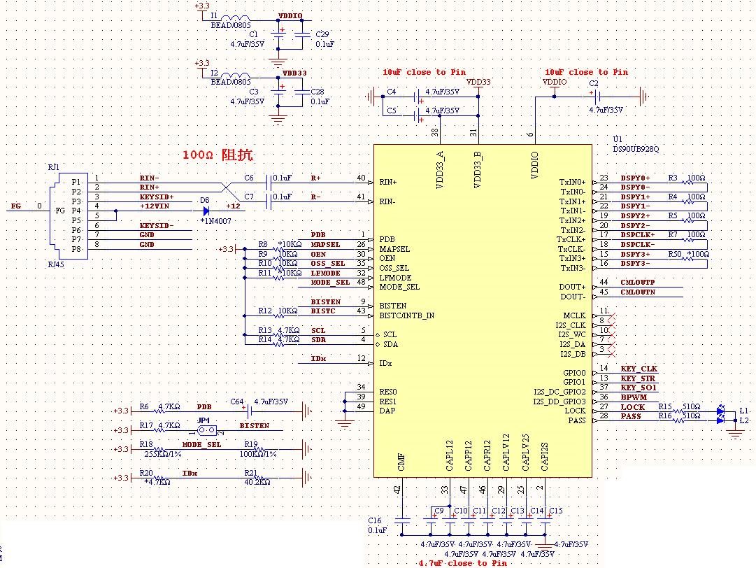

(b)The hardware configure of DS90UB928(RX).
MAPSEL=low
OEN=high
OSS_SEL=high
LFMODE=low
REPEAT=low
BKWD=low
I2S_B=low
LCBL=high
DS90UB928 schematic

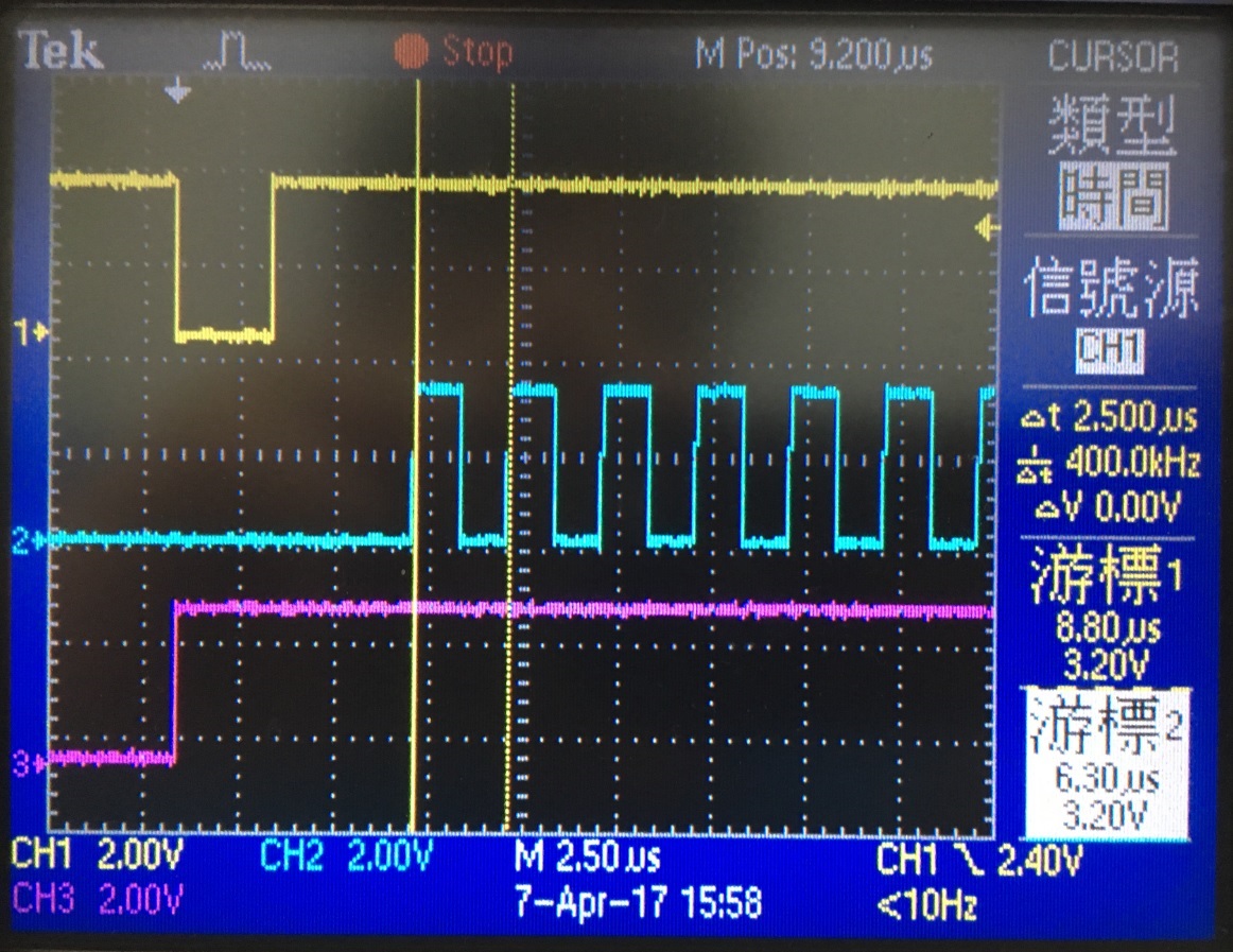

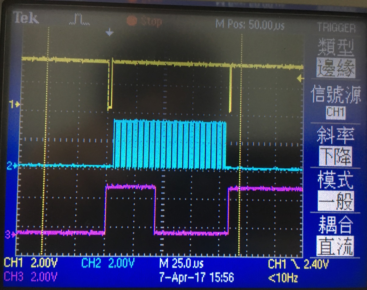

TEST2: Please refer to the waveform of the scope(shown as below), GPIO[2:0] of DS90UB927 input chanel[3:1] signal respectively. (these signals output from CPLD)
Result: The LOCK and the PASS pin of DS90UB928 both output low, LCD can't display(no signal), and GPIO[2:0] of DS90UB928 always output low.
TEST3: Please refer to the waveform of the scope(shown as below), GPIO[2:0] of DS90UB927 input chanel[1] signal.
Result: The LOCK and the PASS pin of DS90UB928 both output high, LCD displays normally, and GPIO[3:0] of DS90UB928 outputs chanel[1] signal.
TEST4: Please refer to the waveform of the scope(shown as below), GPIO[2:0] of DS90UB927 input chanel[2] signal. (400Khz)
Result: The LOCK and the PASS pin of DS90UB928 both output high, LCD displays normally, and GPIO[3:0] of DS90UB928 outputs chanel[2] signal.
Question: Why DS90UB928 can't lock under test2 condition?
