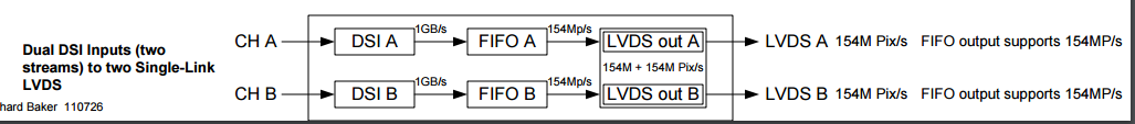

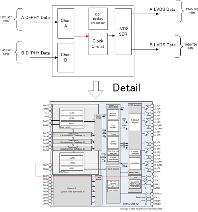

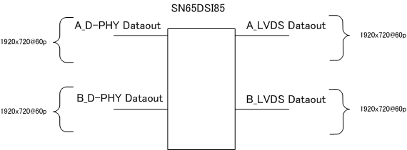

I would like you to confirm whether following usecase can be acceptable or not.
* Two input at 1920x720@60 and two output.
According to datasheet, it seems that up to 154MHz is limitation in case of Dual link.
So above usecase can be acceptable.
However, I would like you to confirm that my understanding is correct just in case.
So could you confirm whether my understanding is correct or not ?
