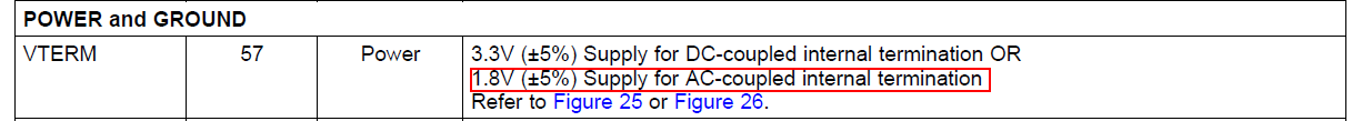

2. The HDMI source only support AC -Coupled output, how to setting DS90UB949-Q1 to compatible this,just supply VTERM 1.8V? And the value of the coupled capacitor,100nF?

    2. yes, you can refer to section 7.3 recommended operating conditions in UB949 d/s
