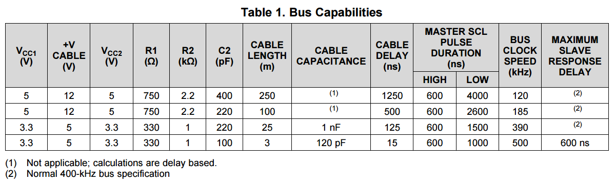

I'd like to extend the I2C bus using two P82B96 buffer chips.
<Requirement>
・I2C bus speed  400KHz
・Between 400 MHz band radio equipment and external I2C device
・Distance 10m
Can P82B96 support this application?
Are there other recommended devices?
