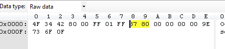

I download an image to my TPS65982 and then connect to a Dell laptop and trace the PD traffic. No matter which image I use, the Discover SVIDs Ack message that comes from the TPS65982 on my board has byte 6 = 01, byte 7 = FF, byte 8 = 87 and byte 9 = 80. Bytes A-D have 0x00 in them for the two required blank SVIDs. It doesn't matter which image I load, I always get the same order. Here is what the trace is in either case:

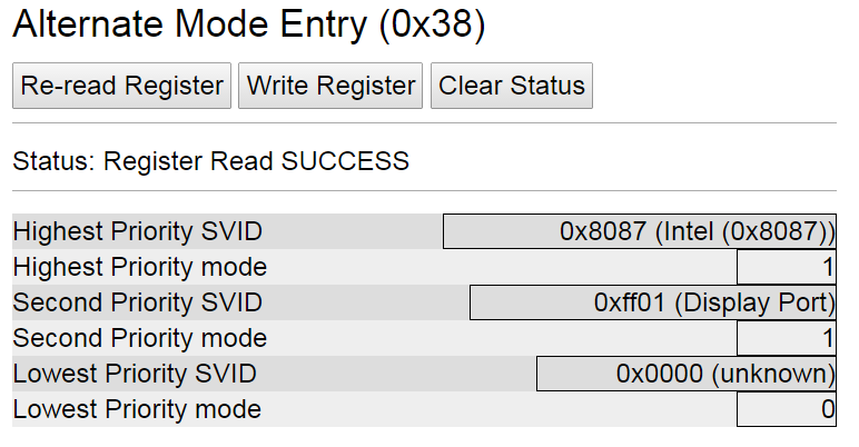

For TBlt 1st, the raw value read using the 'read' command is 0x1ff0100018087L. Using the register list and reading register 0x38 I see the Highest Priority SVID = 0x8087, and Second = 0xff01. Here is a picture from the 2nd:
I also confirmed this by using the read/write commands and changing register 0x38 in one image. So, why is the TPS65982 responding with the SVIDs on the PD handshake going out in the same order, no matter what register 0x38 says?
I looked at the traffic with two different PD analyzers and they both show the same order. When I read the Data Status register with the HIT, it says that a TBlt connection is made with either image, so apparently bytes 8 & 9 of the Discover SVIDs Ack message has priority. The Rev3, v1.0 PD documentation isn't clear on which one of the two in a word has priority, it shows SVID0 = bits 31:16, and SVID1 = bits 15:0. It seems like the Dell is choosing bits 15:0?

  • Something else that is a slight problem... The only way I can use the HIT tool to re-write this register to change the order is to use the 'read' and 'write' commands, I can't change it using the Register List -> 0x38 view and the 'Write Register' button. It ignores my changes and switches it back to what it was before.

    I have seen this before as well. I will use register list to write something then go back in the same register to find my write has been over written. It should work. I would suggest to re-read the register to confirm it has been written right after you write it.
