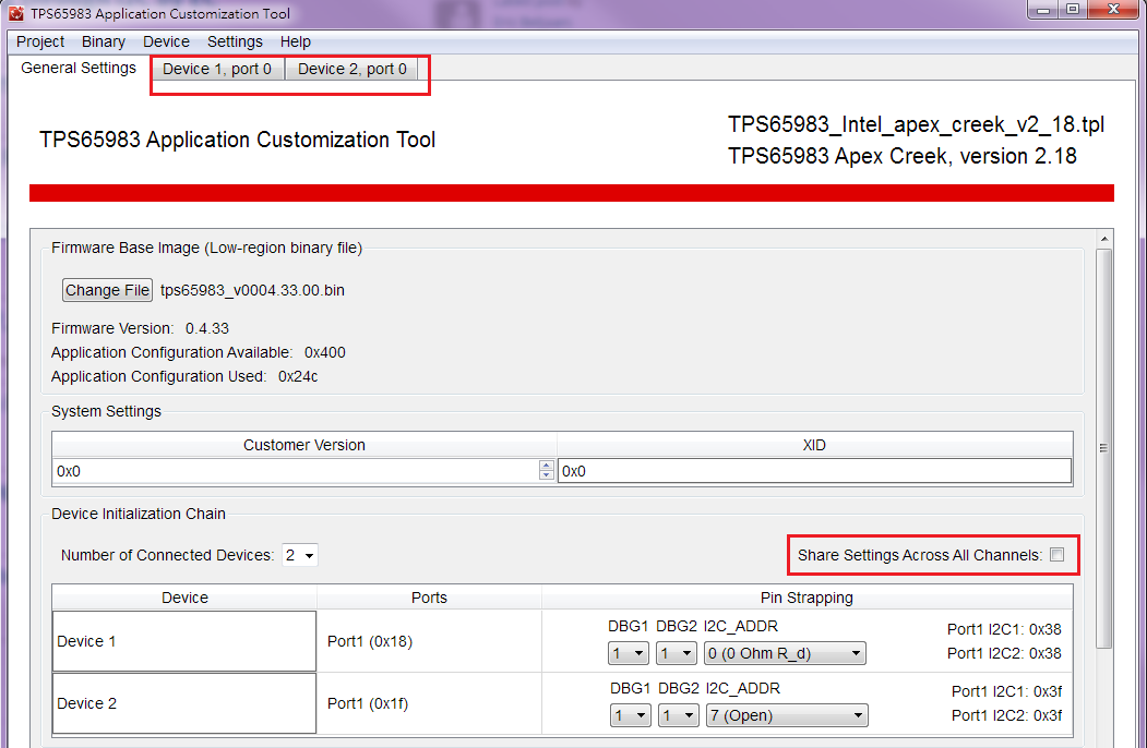

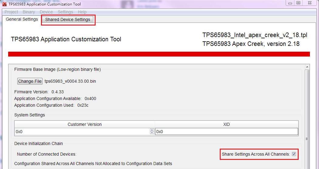

I have a question about the "Share Settings Across All Channels" config. the default setting is checked. It means the TI FW should use the same setting that set in the "Shared Device Settings" page for all channels. So I save this project file and build a TI FW for testing.
But it doesn't share the setting across all channels because I load the project file w/ share setting and uncheck the "Share Settings Across All Channels" config. There are two device setting page: device 1 and device 2, only the device 1 is my setting. Device 2 setting is not the same as device 1 but not the default setting.
1. Is there someone get the same question, can I trust the default shared setting or just config each device to make it correct?

    1. Disabling the "Share Setting Across All Channels" setting is used when you want to program multiple TPS6598x devices using a single flash chip. You can also use it to have potentially two different configurations that can be loaded onto the TPS65983 device. When "Share Settings Across All Channels" both I2C ports will receive the same configuration.

    1. Our device is two port TB3 device and it should share the same TI configuration. At first time, I checked the "Share Setting ..." option and setup TI FW w/ our config in v2.14 config tool. But our partner member said that it not enough. Furthermore, it needed to enable the "show Bitfield Ranges" then set both Device1 and Device2 in the config tool, then the two port used the same setting exactly. But now v2.18.1 tool can't follow this procedure. Therefore, they tell me to ask this question here.
    I am not familiar with HW, but I know our device has two TPS65983 chips. Hence, do I need to use "Share Setting ..." option or not?
    And if I need to use(check) the option, all I need to do is setup the Shared Device Settings then the two port setting are the same, could you help me to confirm the tool just works like what I think.
    2. Unfortunately, our HW member doesn't have the EVM of TPS65983. I can't do this testing. Could you kindly explan below setting items in Import device setting for our HW reference?

    1. Yes, you are correct. When you select "Share Setting.." option, all devices will receive the same configuration. In your case, both TPS65983 will receive the same configuration.
