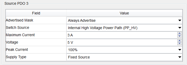

Hi expert,
As title, my customer want to use PP_HV to source 5V/9V/15V, and just disable PP_5V path,  I have tried to config it with TPS6598x Application Customizer tool, but it seems once i disable the PP_5V path, the typeC port can not support power source anymore.
Dose it means the  v_safe 5V only can sourced by PP_5V? Why we have that limit? Thanks!
