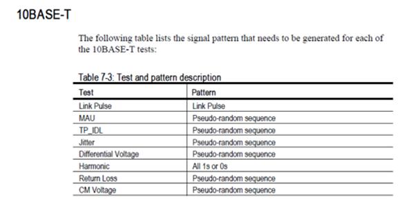

Hi Team,
Customer is evaluating the DP83848K.( the part numbe is 48k, not 48C) If customer would like to measure the 10BASE-T internet signal for the following waveform.
Whih registers need to set for the pattern?
Thansk,
SHH
  • Hi team,
    Here are the customer setting. But it does not work.
    Please provide your comment for how to generate the pattern.
    #RX
    phy_ctrl write 0x19 0x4003
    phy_ctrl write 0x1A 0x0844
    phy_ctrl write 0x1B 0x0030
    #TX
    phy_ctrl write 0x19 0x0003
    SHH
  • Hi SHH,
    You should enable BIST and force a 10BASE-T link as well. Please change/add the following:
    Receive Path
    write 0x0100 to register 0x0 // force 10BASE-T
    write 0x4103 to register 0x19 // enable BIST and force MDIX
    write 0x0844 to register 0x1A // force 10BASE-T link
    Kind regards,
    Ross
