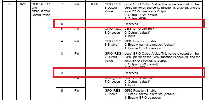

Our Customer is considering Ds90UB927/928 system.
According to the datasheet, GPIO_REGx configuration bit2 and bit6 is reserved.
But these registers can use by ALP UI.
Is ”GPIOx REMOTE ENABLE” register available?
