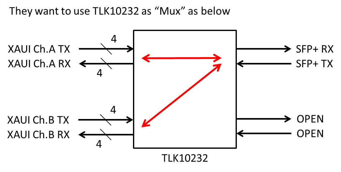

My customer would like to switch LSs to chA HS as below. And they will use 10G-KR mode. They plan to connect SFP+ module at ChA HS so they send the commend below prior to the command for switching above.

  • Hi Luis-san,
    Thanks for your quick response and I was debugging the switching sequence on site today so let me feedback.
    I will need to attend the debugging tomorrow as well, so please response to questions below in 9 hours.
    I got a two topic today.
    1. Double check the switching sequence
    2. LS_ALIGN_STATUS pass condition
    [Double check the switching sequence]
    Unfortunately, the sequence you mentioned didn't work today. It seems that the switch pass is cleared and gets back default after sending Data pass reset command. The DST and DSR Control registers are definitely written, but issuing  the Data pass reset  will initialize the read value of the DATA_SWITCH_STATUS register. Please check it with EVM on your environment. I can see same behavior on my desk.
    Then, Should we need to issue Data pass reset after writing DST and DSR setting?
    Also, when we just unplug optical cable from SFP+, the data pass setting has initialized. They do not want such unexpected channel changes, Is it impossible to completely fix the connection channel with MDIO setting?
    We are suspecting these register might corresponding this behavior so it's greatly appliciated if you give us any additional explanation to clarify this issue.

    Fortunately, We could establish the link through LSA to HSB using the setting as you mentioned.The reason for not linking properly was in the XAUI source. After fixing FPGA code, we finally see asserted  LS_ALIGN_STATUS bit.
    Thanks for taking your time on this.
    Could you double check if the each status below is as you expected just in case?
    Channel A(Using High side)
    CHANNEL_STATUS_1 0x00F 1C03
    PMA_STATUS_1 0x001 0006
    PMA_STATUS_2 0x008 B000
    PCS_STATUS_1 0x001 0006
    PCS_STATUS_2 0x008 8001
    Channel B(Using Low side)
    CHANNEL_STATUS_1 0x00F 7003
    LS_STATUS_1 0x015 C143
    As the result, We understood that ChA's PMA and PCS status should be referred to check the operation properly in the case(LSB to HSA switching).
    1. [Switching initialized issue]
    But the issue that the switch is initialized arbitrarily has not been solved yet. It seems that the issue occurs when TLK10232 gets "local fault" due to some reason such as OPT cable unplug.
    So We are guessing ON_OFF feature in data switching control is related to this issue. We were looking for the register to disable the ON_OFF feature and reached out the registers below.
    DST_FORCE_SEL[4:0]
    DSR_FORCE_SEL[4:0]
    In fact, We succeeded in solving this problem by setting the registers.
