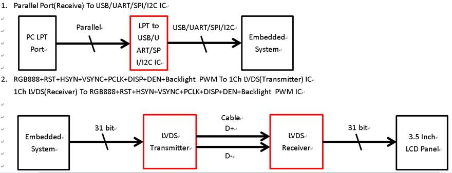

Hi team,
I plan use TI solution design our product.
Do you have good solution for red block can suggest to me ? thanks.
  • Hi Cao -
    For your first requirement, I think an MCU solution is probably the only way to do something like this. You would need a part that has enough pins on it to support the parallel interface as well as the USB and other serial interfaces you're looking for. From TI's MCU lineup, I think the best options are our Tiva devices, or an MSP430.
    A good device to start with from the Tiva family would be the TM4C129 series - these support USB, SPI, I2C and UART, and have an external peripheral interface that could potentially handle the LPT interface.
    www.ti.com/.../tm4c129encpdt
    John
  • Hello Cao,
    For 2., The closest devices we have to what you need are the SN65LVDS305 and SN65LVDS306 Tx, Rx devices or the DS90CF383B and DS90CF384A Tx, Rx devices.
