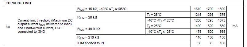

They would like to make sure the measurement value of current limit under the following condition.
 Vin = 5V or 3.3V
 Rlim = 15k or 20k or 49.9k
 Ta = 25C
