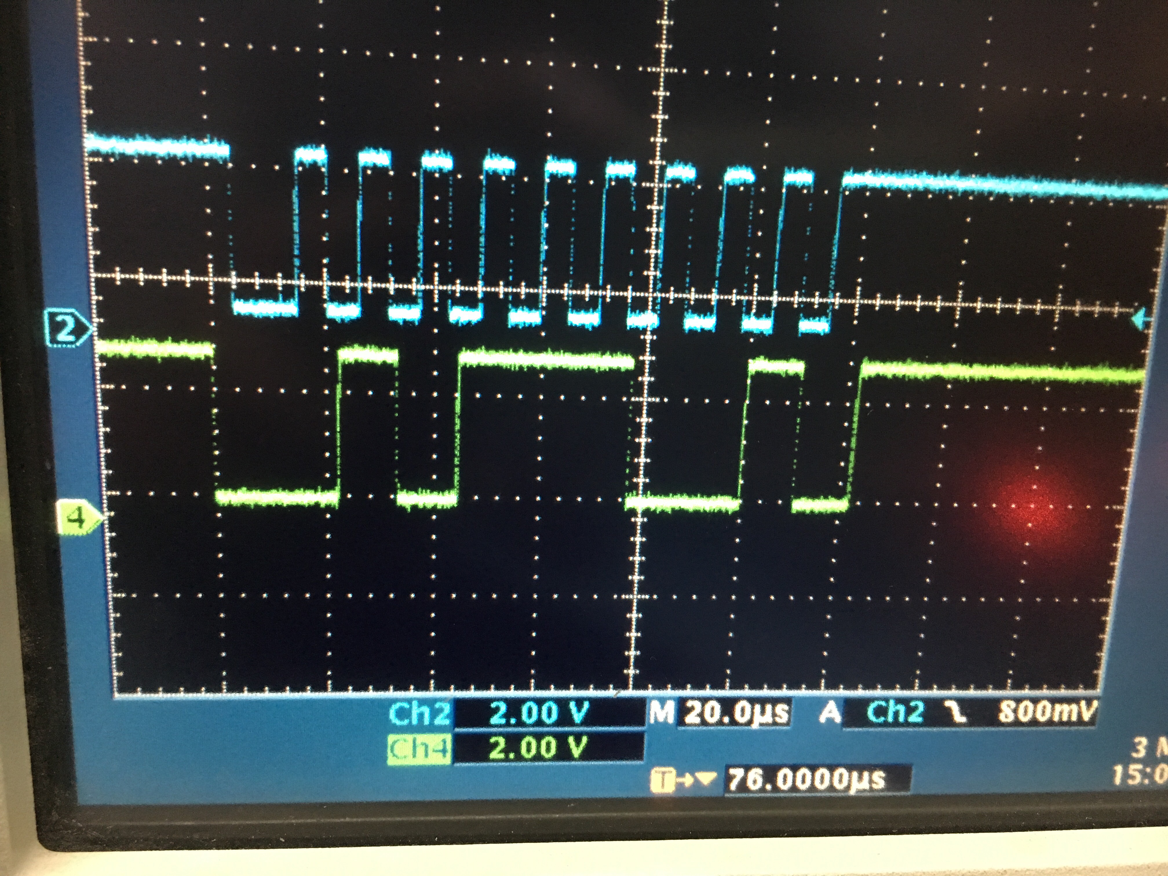

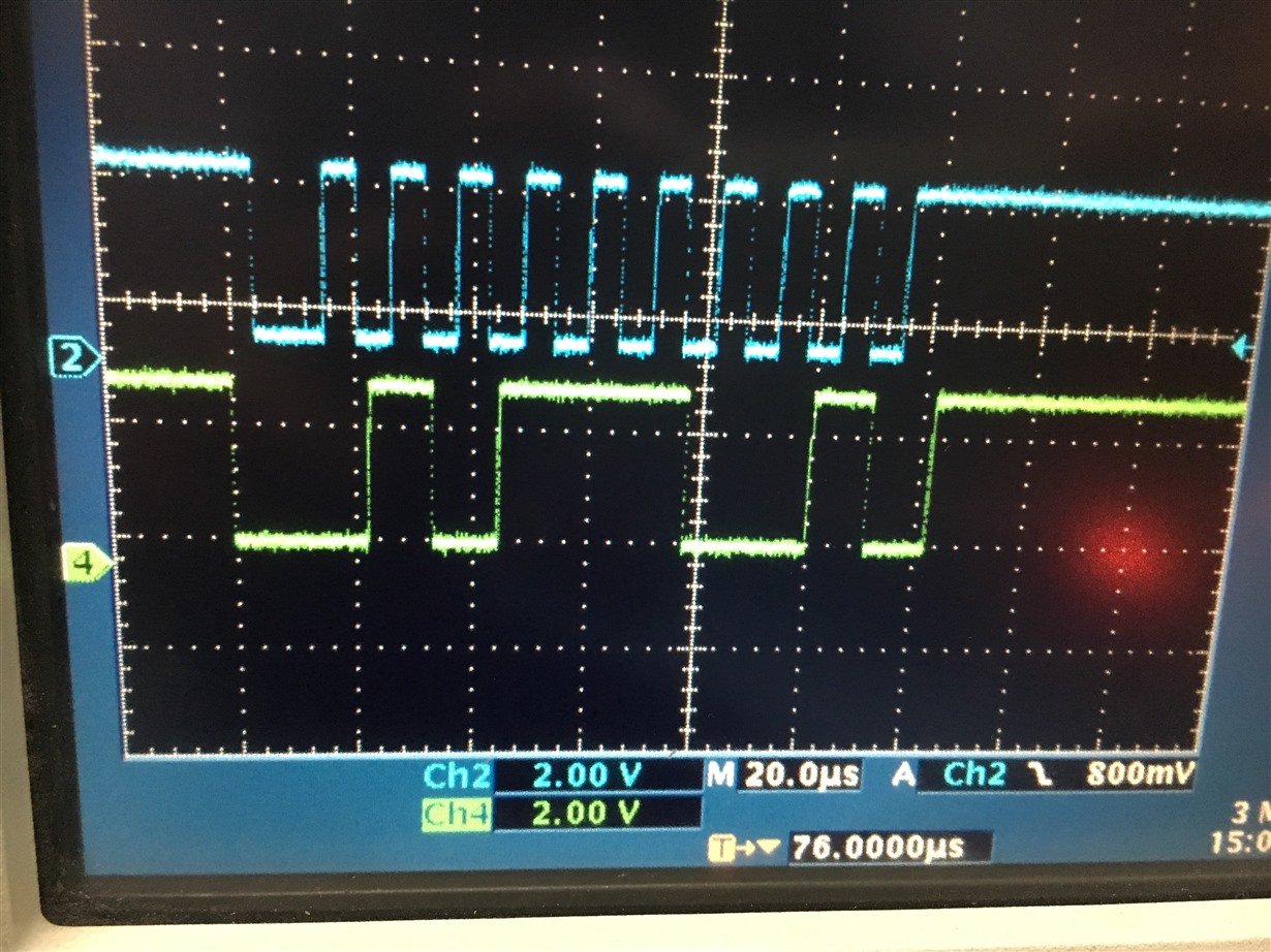

We are using SN75DP130SS in our project and it's I2C is driven by ZynQ SOC processor. We are finding issue that I2C is not responding and we are not getting Ack bit from I2C commands.

    Can you share scope captures of the NAK transaction?

    Yes, you are right. Please find the scope captures and complete schematic.

    In the scope capture, you are using I2C address 0x2E, to have this address you need to populate the pull-up and remove the pull-down on ADDR_EQ pin.

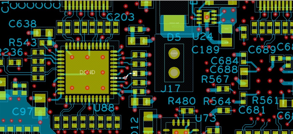

     4. Could you confirm the PCB has a solid pad from DP130's I2C pins to master pins?
      Attached Board top layer snap, focusing device footprint.

    Regarding the path, I wanted to confirm DP130's pins 4 and 5 are connected to I2C bus, this is to discard a soldering or broken path issue.
