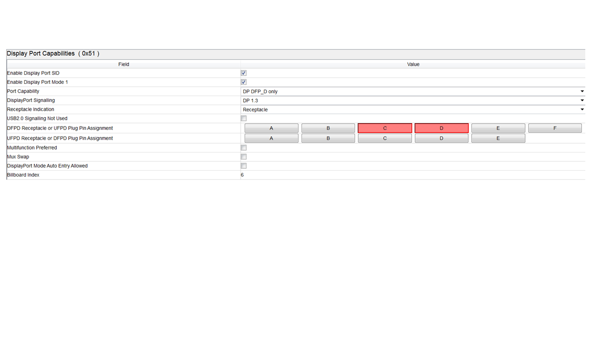

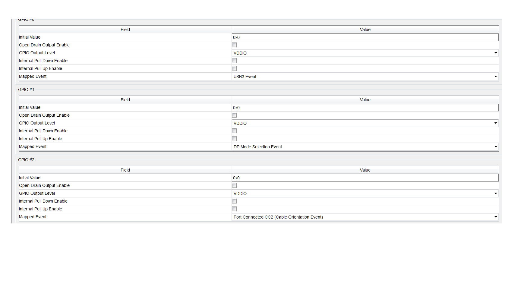

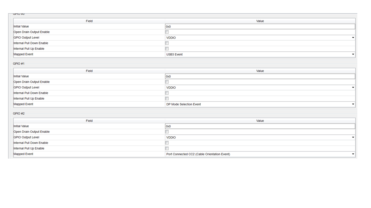

How  to configure TPS6598x support 2K video resolution switching to 4k resolution in Alternate Mode with TUSB546EVM to work with Type C monitor.
the type C monitor could support switch between 2K(USB3.0+2Lane) and 4K(4Lane) resolution by pressing the button in monitor.
my requires is that PD controller works as DFP and SRC, port could not support data/power role swap.
right now I select or de-select the multifunction preferred in Display Port Capabilities setting, it work for  2K setting, but fails after switching to 4K setting.
Pls help for the right configuration setting for this requirement, thanks
