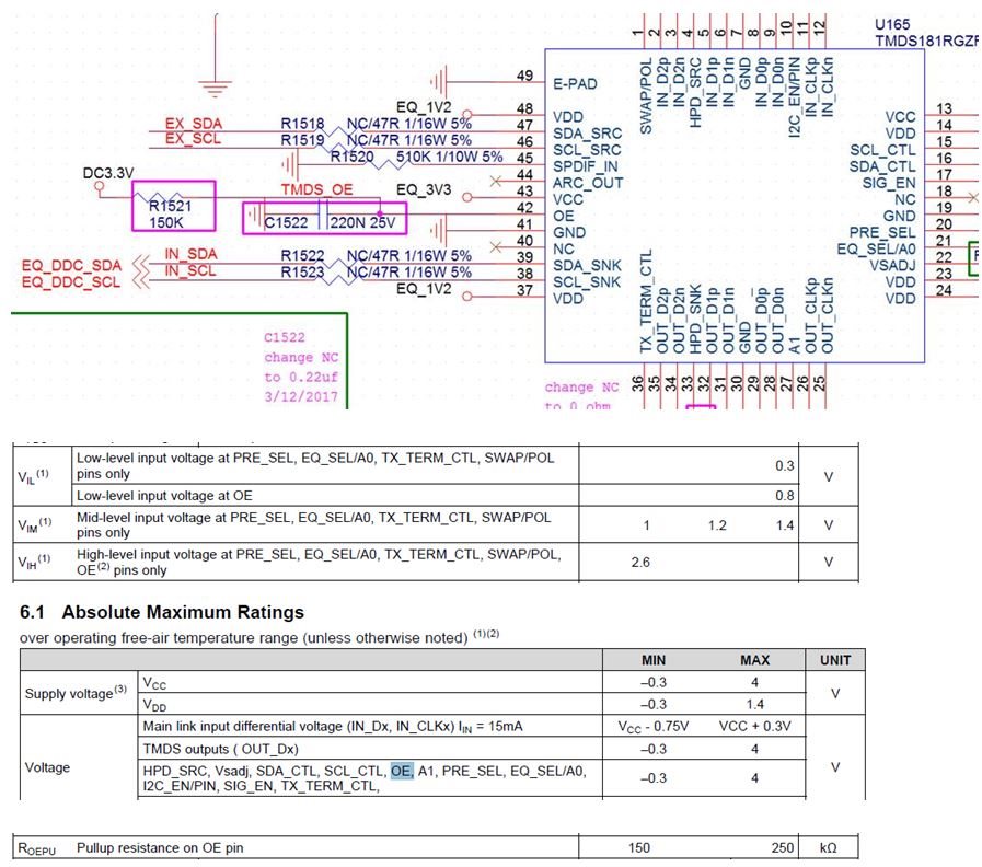

TMDS181: Asking for the TMDS181 schematic review
Part Number: TMDS181
Hi Team,
Could you please check OE pin schematic is or not?
SHH
  • Hi Scott,
    OE pins can be used with external capacitor and resistor, however, the pull-up will reduce the time it takes for OE to reach a high level.
    Common application is to just populate the capacitor with a value according to Vcc/Vdd power ramps, please review power-up sequence from the datasheet.
