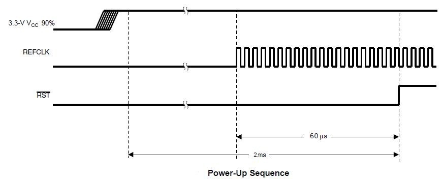

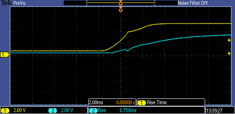

We are currently having issues with the TUSB2046B and it not being recognised every once in a while. We have seen it many times now and cannot track down the cause. We have scoped the power on and the time seems extremely slow. Our RC circuit on Reset pin incorporates a 15k resistor and 100nF Capacitor.
Any help with where to look would be of great help!
