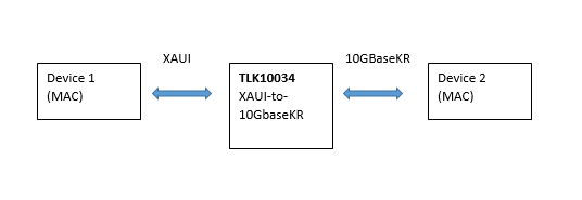

We are facing some difficulty while using the device TLK10034.
We are using the device in XAUI -to- 10G BaseKR mode as shown below.
(The DEVICE2 is on another board), other than the XAUI-10GBaseKr link, there is no connection between the DEVICE1 AND DEVICE2.

The XSMI of TLK10034 is connected to Device1.There is no other interface connecting the device1 and device2.
Device1  knows the link status between TLK10034 and Device2 by reading the registers of TLK10034.Since these PCS status registers are not reliably indicating the status of the 10GBaseKR links, we  are finding it difficult to know the status of Device2.

  • Hi Prahlad,
    When the register 0x1E.0001 bit[15] is asserted/deasserted (power down enabled/disabled) a data path reset is required (write 0x0008 to 0x1E.000E) .
    As well, the devices powered down the status bits may not be valid since the clocks are disabled. The MDIO management serial interface remains operational when in register based power down mode.
