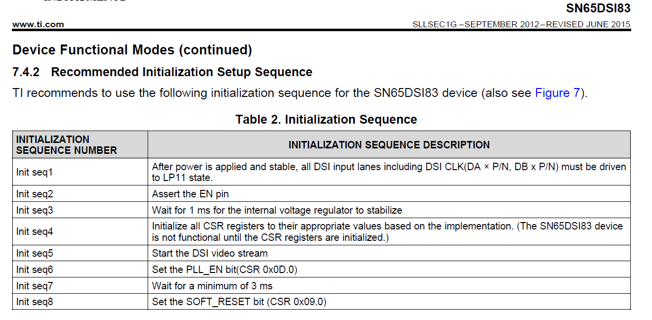

  • Hello Nestor,
    Please, double check that your systems follows the initialization sequence requirement. It states that the host must drive DSI outputs to LP11 prior the transaction to HS mode. Therefore, make sure you have the MIPI inputs driven to LP11(both P and N pairs of all MIPI DSI differential pairs to single ended high ~1.2V) prior to asserting EN pin.
    Provide the status of IRQ Registers.
  • Hello Joel,
    Thank your for your quick response.
    We modified the setup sequence as you mentioned. Following exactly as described in the datasheet section 7.4.2
     But it showed no effect.

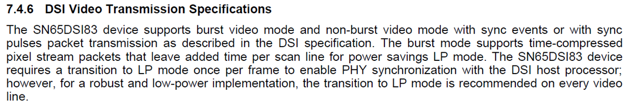

    I noticed that it mentioned in section 7.4.6, that transition to LP mode is recommended on every video line.
    But it also mentioned that in order for the DSI83 to work using D-PHY clock, the D-PHY clock should be continuous(free-running). In our setup, the D-PHY clock is HS mode all the time, no transition to LP mode implimented. could that be the root of this issue?
    So, how should we conifgure the D-PHY clock correctly?

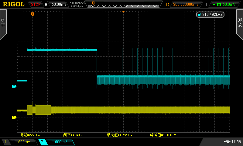

  • Hi Nestor,
    The requirement is that the D-PHY clock lane must be continuous in HS mode when the channel A clock is used as the LVDS clock source.
    Can you share a scope capture showing EN terminal, DA0P, and DACP when EN is asserted?  We need to confirm if  your are meeting the timing requirements stated in the Figure 4.
    The PLL_UNLOCK is a CLK issue, but if you are getting test pattern correctly, it may be been set during the initial setup. You have to check if this bit is being set back to 1 after it's cleared. If you continue detecting the PLL_UNLOCK error, the input CLK is likely having a signal integrity issue.
  • Hi Joel,
    The scope capture is as follows, the yellow waveform is DACP and the blue one is DA0P, the EN is turned on at the  "T" marked time line in the uppper left corner of the capture.
    So it's DA0P and DACP comes first, and after around 18ms, the EN signal was issued. and more than 210ms later, the MIPI data lane switched from LP11 to HS mode.
    Besides, I checked the IRQ register 0xE5, if DSI83 outputs test patern, the value is 0x00, and if the test patern feature is turned off, the 0xE5 reads back a value of 0x80 after being cleared. So it means a CHA_SYNCH_ERR error  occured.
  • Hi Nestor,
    It looks like the DSI Clk (DACP) signals is not driven to 1.2V ( LP11)  when the EN terminal is asserted.
