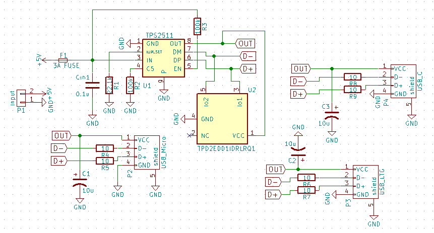

Hello
This is Mohammed ALHAYEK, electronics engineer working in a startup in Paris, France, developping Public chargers for smartphones in the public places like gym's, bars, & resturants.
Recently we bought one of your products - TPS2511 -  to integrate it in our circuit inside the product, & we have one issue that I wanted to check with you if it will make some troubles for my product or for the smartphones of my clients.
The issue can be summarized that I'm connecting three outputs - USB ports -  in parallel to the TPS2511 output pins (OUT, D+, & D-) & I'm afraid that connecting the D+ & D- pins of the three USB ports in parallel can damage the chip or the smartphones of my clients because D+ & D- pins in the TPS2511 are working as I/O, although I'm not dealing with data in my application that concerns only power delivery to the outputs.
Can you check this issue please & tell me your opinion about the ability to connect three USB Ports in parallel ?
You can check the schematic of my design below.
Thanks in advance
