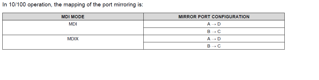

We want to use Mirror mode in 10/100 configuration.
so, in this case, as mentioned in datasheet - A map with D and B map with C.
We want to map - A with C and B with D. is this possible?
is this Auto MDI-X applicable for mirror mode also?

  • Hello Rob,
    so, as per your statement, if we can  connect "PHY MDI pair C to RJ-45 pair A" and "PHY MDI pair D to RJ-45 pair B". the only thing we need to assure that the PHY should be configured in mirror mode.
    I got confused from the datasheet statement in section 8.4.6.7 (attached snapshot). As with this statement in MDI and MDI-X both configuration A is map with D and B is mapped with C.
    Please just reconfirm this.

  • Hi Tarang,
    The table is slightly confusing in that it shows the connections of the drivers inside of the PHY only related to the port mirroring option.
    The MDI/MDIX mux is post port mirroring, and as such, channel A will still act as channel B when in MDIX mode.
    I think this section of the DS can be clarified and I will queue that change.
