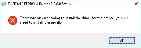

I have a problem with installation of EEPROM Burner. At the end, message box appears:
I installed 6.7.2.0 driver, but EEPROM Burner still can't find any device.
I am running WIN 10.
Can you help me with this problem?
V. Svoboda
  • Hi again,
    the problem was caused by Windows driver signature verification.
    To turn it off, open command line and type: bcdedit /set testsigning on
    Uninstall current EEPROM Burner, restart your computer and install it again.
    To leave test mode and turn signature verification back on, type bcdedit /set testsigning off and restart.
    Hope it helps someone.
