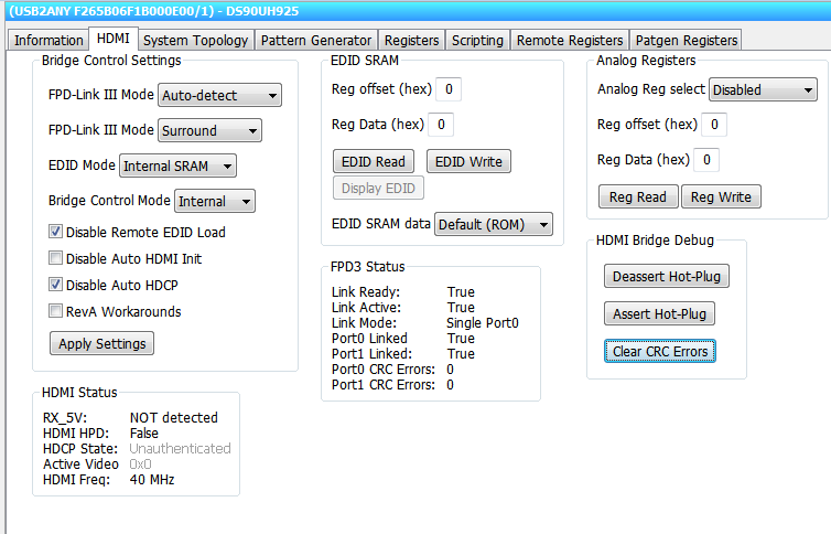

We are about to count CRC errors with ALP tool.
What is indicating with link ready:true and link active : true?
What register value is reflected?
・Link Ready :True
・Link Active :True
And do you have manual to use ALP?
BestRegards
    There is no guide for ALP, but there may be useful information in the EVM user's guide for the specific EVM you are using.
    Link Ready is reflecting the status of 'FPD3 Link Ready' in register 0x5A[7].
    Link Active is reflecting the status of 'FPD3 TX Status' in register 0x5A[6].
