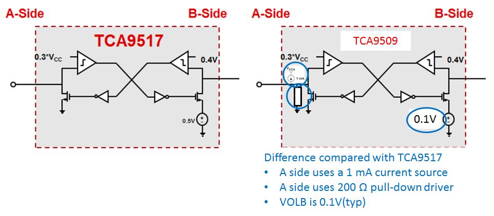

Please let me ask the simplified internal example of TCA9509. I found simplified internal example of TCA9517 following thread.
Then I guess TCA9509's one by referring it so can you confirm it and give your comment? It's appreciated if you can share the TCA9509's simplified internal example here.
