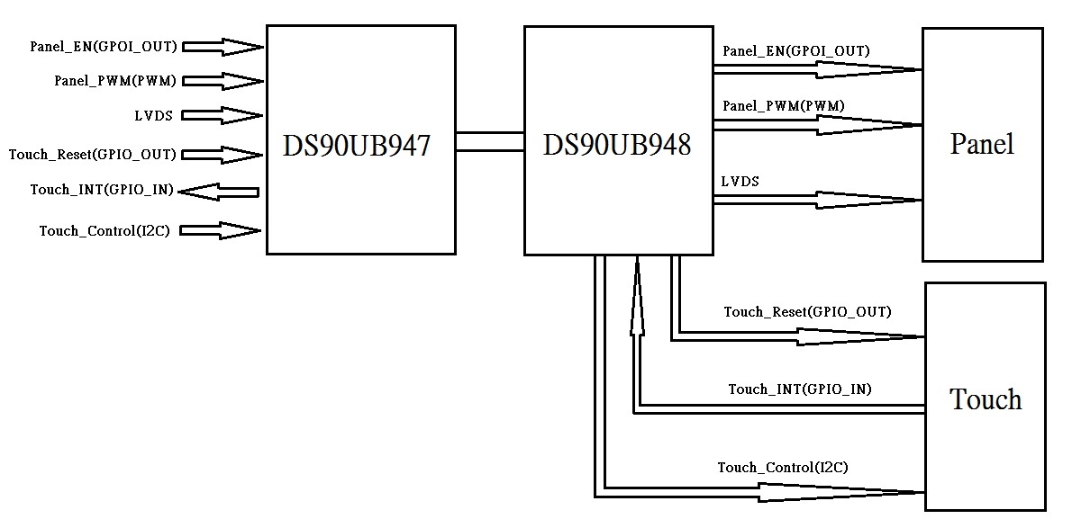

    We have three new questions.
    1. Have any suggestion on 947/948 pin setting that could meet function block?
    2. If we need follow function block, do we need any setting of 947/948 on turn on system moment?
    3. Because touch is control by main chip, the panel control by another MCU. We need had screen before turn on system. The I2C is used on Touch, we couldn't use MCU to control 947 by I2C when turn on .
    Have any suggestion on this?
    Thanks for your help!!!
  • 1. Yes
    2. Yes, you need configure the GPIO and I2C pass through
    3. is the MCU connected with I2C of UB948? if NOT, it does NOT visit UB947 via I2C.
    regards,
    Steven

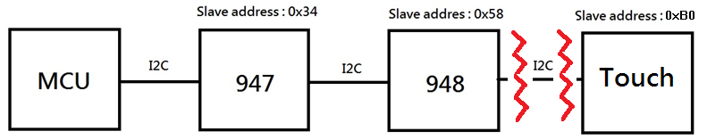

  • Hi Junqiang,
    Thanks for your reply
    Some question on I2C setting
    The I2C looks only connect to 947, But 947 will to pass non 947 packet to 948, if not 947/948  packet that will send to next device....
    Looks like pic
    If we need communication to touch IC, we don't need modify the touch driver, right??

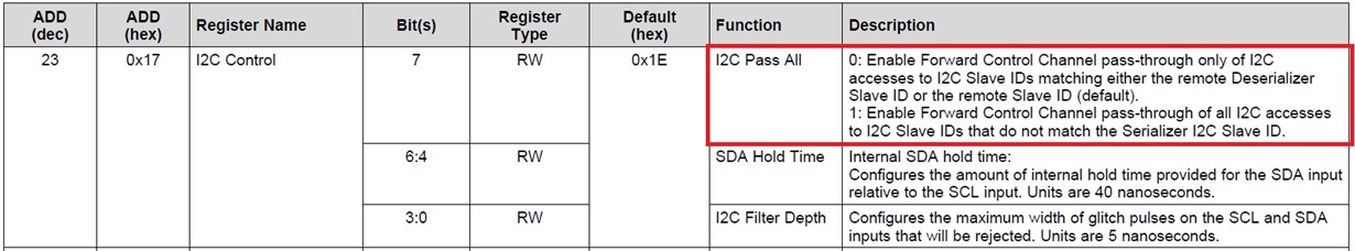

    In addition, if need pass I2C to touch, do we need any setting? 947 0x17[7] and 948 0x05[7] I2C Pass All? 947 and 948 0x03[3] I2C pass-through?
    Do we need registered slave id and slave alias??
    Thanks for your kindly help.
  • Shucheng,
    yes, it is right.
    one example for I2C control is:
    Set I2C Pass-through
    Set SlaveID0
    Set SlaveAlias
    Read/Write to Slave using SlaveAlias address
    also, you can visit my.ti.com, to get the FPD-Link I2C application note, thanks.
    (www.ti.com/.../snla131a.pdf)
    best regards,
    Steven

  • Hi Junqiang,
    Thanks for your reply.
    As below function block
    I would like use MCU to control 948 or panel by I2C signal
    1. We only need write 948 or panel's slave address then 947 will by pass signal to 948 and panel, right??
    2. If not, do we need setting 947 Slave ID?
    3. If need setting, could you explain how to do it?
  • Shu-Cheng,
    1.Yes
    2. you need configure the I2C
    3. One example for I2C control is--
    a. Set register I2C Pass-through in UB947
    c. Set register SlaveID0 in UB947 with 0x0D
    d. Set register SlaveAlias in UB947 with 0x0D (or others)
    e. Read/Write to Slave using SlaveAlias address 0x0D (or others) through MCU
    best regards,
    Steven
  • Hi Steven
    Thanks for your quick feedback.
    So we config 948 step is follow as below, right?
    c. Set register SlaveID0 in UB947 with 0x58
    d. Set register SlaveAlias in UB947 with 0x58 (or others)
    e. Read/Write to Slave using SlaveAlias address 0x58 (or others) through MCU
    or we could use MCU send 0x58 to config 948?
    As below table, for our design it's mean if we config 1 on red circle, besides 0x34 slave address will by passed to rear end, right?
    If yes ,could we don't setting SlaveID0 and SlaveAlias the direct control 948 and Panel?? Have any risk or restrictions
  • Shu-cheng,
    you just need configure UB947 not ub948. the UB948 I2C address would be transmitted to UB947 automatically, you can read the register 0x06 of UB947.
    0x06[7:1] in UB947 d/s: ---------------------------------------------------------
    7-bit I2C address of the remote Deserializer. A value of 0 in this field
    Port0/Port1 disables I2C access to the remote Deserializer. This field is
    automatically configured by the Bidirectional Control Channel once RX
    Lock has been detected. Software may overwrite this value, but
    should also assert the FREEZE DEVICE ID bit to prevent overwriting
    by the Bidirectional Control Channel.
    If PORT1_SEL is set, this field refers to Port1 operation.
    best regards,
    Steven
  • Hi Junqiang,
     We read register 0x06 of UB947, the value is show  “0x58”, it's can do W/R on 948 . So looks  948 is OK.
    It can't communicate with 948 touch device
    We found no output on 948 I2C Clk/Data
    Have any setting we missing?
     947/948 init as belwo :
           #define I2CAddress_947  0x34
    #define I2CAddress_948  0x58
           WriteI2C947(I2CAddress_947, 0x03, 0xDA);       //Set I2C pass-through mode enable.
           WriteI2C947(I2CAddress_947, 0x07, 0xB0); //Set Slave ID.
           WriteI2C947(I2CAddress_947, 0x08, 0xB0); //Set Slave Alias.
           WriteI2C947(I2CAddress_947, 0x1E, 0x02);       //PORT1_SEL set 1. use 947 D_GPIO.
           WriteI2C947(I2CAddress_947, 0x0D, 0x03);       //set 947 D_GPIO0 is GPIO input
           WriteI2C947(I2CAddress_947, 0x0E, 0x33); //set 947 D_GPIO1&2 is GPIO input
           WriteI2C947(I2CAddress_947, 0x0F, 0x03); //set 947 D_GPIO3 is GPIO input
           WriteI2C947(I2CAddress_947, 0xC6, 0x21);       //Enable global interrupt, and Enable interrupt on receiver interrupt.
           WriteI2C947(I2CAddress_947, 0x17, 0x9E);
           WriteI2C947(I2CAddress_948, 0x34, 0x02);       //PORT1_SEL set 1. use 948 D_GPIO.
           WriteI2C947(I2CAddress_948, 0x1D, 0x05);       //set 948 D_GPIO0 is GPIO output, and Enable remote GPIO control.
           WriteI2C947(I2CAddress_948, 0x1E, 0x55); //set 948 D_GPIO1&2 is GPIO output, and Enable remote GPIO control.
           WriteI2C947(I2CAddress_948, 0x1F, 0x05); //set 948 D_GPIO3 is GPIO output, and Enable remote GPIO control.

    I2C pass all is not recommended, please use "pass through" and slave alias registers for configuring remote slaves.
  • Yes, you can visit UB948 via 0x58 address. by the way, if you have other I2C device is connected in the local i2c bus, please use the "I2C pass" NOT "I2C pass all", thanks.

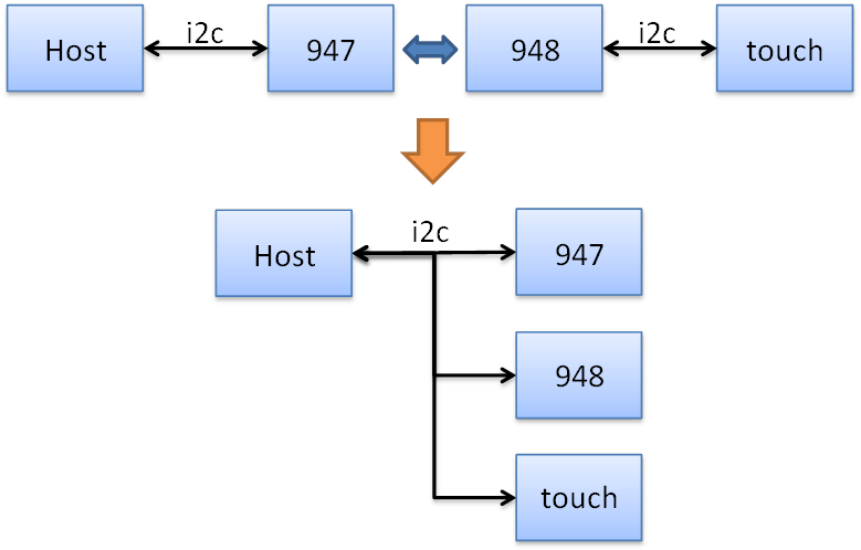

  • Shucheng,
    Yes, you can visit UB948 with I2C address 0X58 from I2C master connected with UB947's I2C BUS. You can enable "I2C pass" in the register 0x03[3] to get better application if it has more I2C slave in the bus.
    also, you can visit panel through the I2C master in the UB947 side, this is one very mature solution for FPD-Link III.
    best regards,
    Steven
  • Shucheng,
    yes, you can use MCU to visit UB948 with I2C ID 0x58.
    it is recommended to configure I2C Pass-through (0x03[3]). as you need visit UB948 and panel in the UB947 side, so you should set the panel as remote slave ID and give its slave alias. after doing it, you can visit the panel with slavealias in the UB947 side. thanks.
    regards,
    Steven
