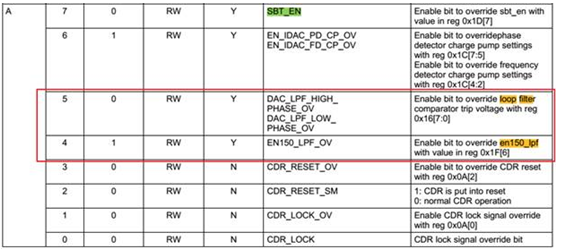

Can you please review the following questions for DS125DF1610? A customer is trying to tune Loop bandwidth of CDR to improve Jitter tolerance, so they ask about which registers to tune.
  -. Is Reg=0x0A bit[5:4] in below table the right register to optimize loop bandwidth?
  -. In addition, is there any recommended register to improve the jitter?

    To increase the CDR bandwidth, the user may set registers to increase the phase and frequency charge pump settings.
    • 0x0A[6] shjould be set to 1 to enable manual override of the charge pump settings
    • Channel registers 0x0C and 0x1C are then used to set the frequency and phase detector charge pumnp settings
    The example channel register write routine below illustrates how to set the charge pumps to a value of 5. Note that the default charge pumps setting is 4.
    REG       Value     Mask      Comment
    0A           40           40            //Enable over-ride of charge pump PD DAC
    1C           A0            E0          //PD CP DAC 5
    0C           00           01           //PD MSB 0
    1C           14           1C           //FD CP DAC 5
    0C           00           02           //FD MSB 0
