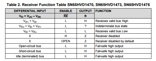

    1. You do not necessarily need to deactivate the RX line to transmit data in half-duplex mode; your mcu will just be able to hear what it is transmitting, which might be helpful for debugging. As I see it now for JP1 for HD mode you are leaving RE and DE open and that will cause an undefined state on the bus A/B per the function table 1 and table 2, although R will be pulled high because you have a pull up on the line.
    Also I believe your FET is only being tie to R_RE and R_DE when JP1.1/4 are on, and it is not actually controlling RE with your current schematic.

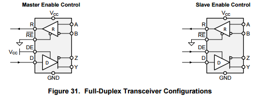

    2. For your Full-Duplex implementation you have the RE and DE states flipped with the current jumper configuration you have RE high and DE low. RE is active low so you need to tie RE to ground and DE is active high you need to tie DE to VCC unless you are using  a control lines like this:
    So you might want to re-look at your JP1 settings and/or function table
    The way the sparkfun is using the FET to control RE/DE is outside of the normal operation of RS-485/422. Some common ways of configuring RS-485/422 (besides the one above) are like this:
    You might want to look into some of these. For you application I would think the Slave Enable Control config might be the most straight forward one to implement.

    1º.- According to 1: "... As I see it now for JP1 for HD mode you are leaving RE and DE open and that will cause an undefined state on the bus A/B per the function table 1 and table 2, although R will be pulled high because you have a pull up on the line...
    Yes, I made a mistake. I attached the screenshot fixed.
    2º.- According to 1: "You do not necessarily need to deactivate the RX line to transmit data in half-duplex mode; your mcu will just be able to hear what it is transmitting, which might be helpful for debugging."
    Ok, for debugging it could be a good option. But for normal operation can be a little bit annoyed, can't it?
    3º.- According to: "2. For your Full-Duplex implementation you have the RE and DE states flipped with the current jumper configuration you have RE high and DE low. RE is active low so you need to tie RE to ground and DE is active high you need to tie DE to VCC unless you are using  a control lines like this:..."
    Yes you are right, I made another mistake, so attached you the changes a the screenshot fixed.
