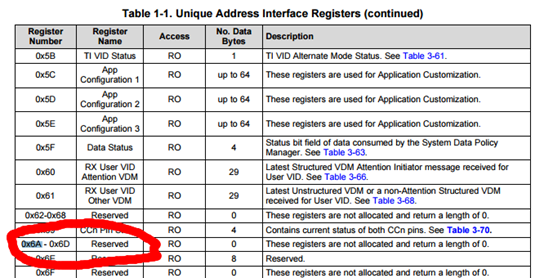

6) I would like to access the most recent current sense values from ADC. 'ADCs' command returns values that do not seem to be correct, and I would prefer to get the values used by TI firmware without starting a new conversion. Documentation mentions "ADC Result" register at address 0x6A, but elsewhere 0x6A-0x6D are shown as Reserved.
