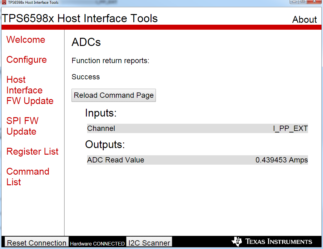

    I managed to get this feature working on my TPS65982-EVM here. Please refer to the Test Report I put together below:
    I_PP_EXT as a SINK.docx
    Thank you,
    Eric
  • First of all, thank you very much for that excellent write up and experiment. I went through the steps you outlined and created an image (after saving away the old EVM image) using the template you suggested. I had previously switched the R2/R6 with the R3/R5 on one of my EVMs and so I re-programmed that board. I then connected to a laptop supplying 5V on VBUS and that could put out 900mA. I did measure SENSEP < VBUS and set up an external sink to draw 0.5A from J6. I made all of the voltage measurements and had the following:
    VBUS = 5.025V and SENSEP = 5.011V. With my sink drawing 0.499A, I measured with the I_PP_EXT ADC reading a value that was around 0.45A, so it was successful!!

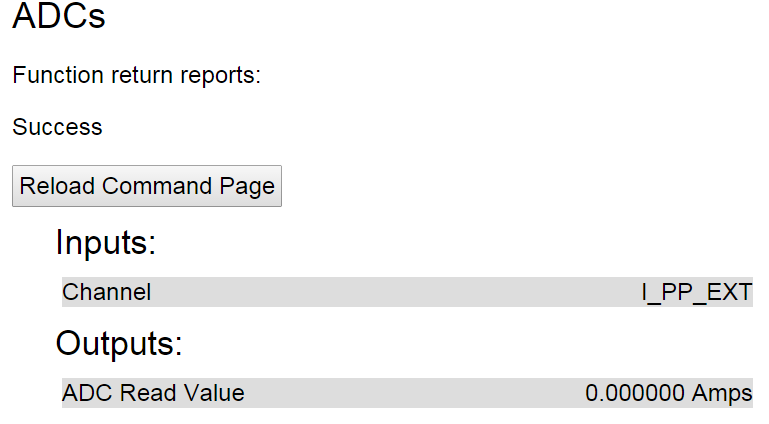

    This doesn't match the operation I want, it looks like this ONLY works in dead battery mode. To test this I disconnected the J6 jumper and reconnected my sink to just pin 2 of J6 and so it wasn't shorted to the 20V External power of pin 1. I then plugged in the power supply to the barrel jack so that the TPS65982 wasn't in dead battery mode. Using the utility tool I modified the image so that the EVM would connect in sink mode with the PD contract and made the connection.
    The changes were to change the System Config register so PortInfo was CONSUMER_CCPD_CCIPU and making sure that I didn't have any Source PDOs, only the 5V/900mA sink capabilitiy. After connection I verified that indeed it was in SINK mode and drawing current from the laptop. I measured the following:
    VBUS = 5.33V and SENSEP = 5.01V. However, with the sink still drawing 0.499A, I measured with the IPP_EXT ADC reading a value of 0.0000V.
    So, I want to be able to read the SINK current when the TPS65982 is powered by the VIN_3V3 pin and isn't in dead battery mode. Is doesn't look like this is possible, unless I can set some other values in the registers.

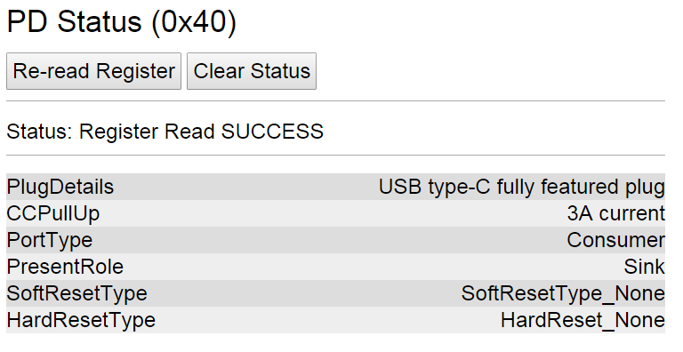

    Here are the pictures I took:
    1) ADC reading set up as you did
    PD status after making changes to have the board powered:
    Status register in powered mode:
    And finally the ADC reading in powered mode, always reads 0.0000A
  • Hi WST,
    It appears from your Status register (0x1a) that RCP is enabled on the External Power Path. The I_PP_EXT function will not work if you have RCP enabled on the external path. To prevent the RCP from being triggered. I followed your steps by removing the J6 jumper, I then booted the 82 in dead battery mode. I then plugged in the barrel jack and cleared the dead battery flag using the DBFg command. I then confirmed that RCP was not enabled on the PPHVE Switch.

  • Eric,
    This is getting very confusing and I suspect I just can't do what I want, and that the datasheet and manuals of the TPS65982 don't describe the operation of the I_PP_EXT path very well (at least to me).
    1) You said: "The I_PP_EXT function will not work if you have RCP enabled on the external path."
    I can't find this anywhere in the Host Interface Tech reference manual, the Firmware Users guide or the TPS65982 datasheet. The closest thing I could find to this is note 4 on the IHV_ACC spec, but the IHVEXT_ACC spec doesn't refer to this RCP only operation and seems to indicate that it should work in these modes.
    2) Your process above is also not documented anywhere. I was able to repeat that with my modified EVM board, but it looks like this only works if I start in dead battery mode. The Host Interface Tech Ref Manual doesn't describe status register 1A this way. It says that bits 8-15 indicate the current state of the switches, not the RCP status. So when I see 'Disabled' I think the switch is turned off.
    Here is the entry in the manual:
    Since I can read the current when this is disabled, I REALLY don't know what is going on or what path is being used. I read this register using the READ command and get: 0x194000d. Bits 15:8 are all '0', so according to this manual, the switch should be opened.
    3) When I look just a little further down in the register 1A readout than you showed, I see that the TPS65982 is in some odd mode, not the operation that I desire:
    4) I have my board wired with the RPD_G1/G2 inputs tied to GND and the BUSPOWER_Z tied though 100k to VP3V3. Because of the first, my board therefore can't boot up in dead battery mode.
    Maybe I'm misunderstanding the manual/datasheet but I don't see a way to read the I_PP_EXT current when operating with a 'normal' PD handshake and while sinking current, even though SENSEP > PP_EXT. If that is true, please let me know. I can't operate my IC/board in an odd way just to get this function to work.
