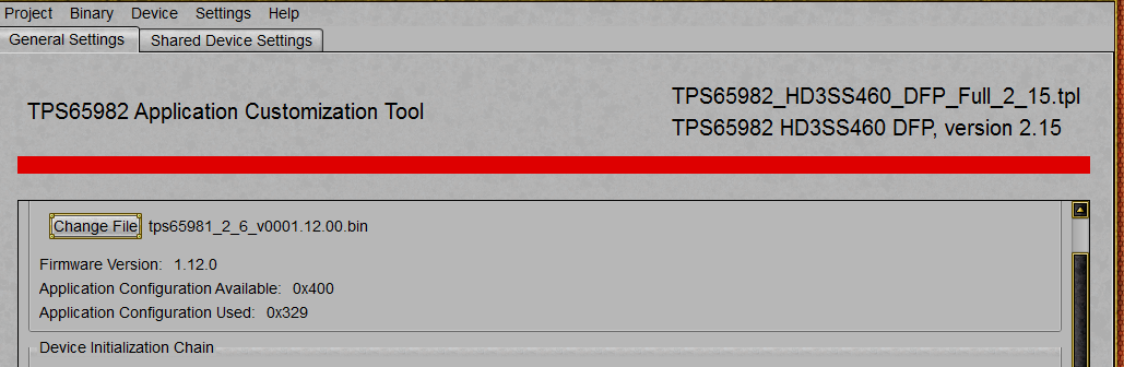

  • Hi WST,
    The FW version on the EVM is most likely dated. Can you load a configuration on the 82-EVM using the 2.15r2 version of the app customization tool and confirm if the error persists?
    Thank you,
    Eric
  • Eric,
      It doesn't look like the flash date has anything to do with the problem. I had some trouble, because I didn't want to lose the original special image on my EVM board. So here are the steps I took:
    1) I used the Aardvark flash utility to read off the current image into a .hex file so that I could put it back later.
    2) I then made an image with Revision 2.15rc2 that was a source with 3 PDOs, the 2nd being the 12V PDO using the I_PP_HV path.
    3) I connected this to my system and made the 12V contract (with my board showing a12V sink / 2000mA contract).
    4) I connected the HI-utility to the EVM board and checked, it said it was sourcing the 12V @ 3A.
    5) I turned on my power supply to sink 1.5A. It said it was doing that and my inline current reader said it was sinking 1.53A.
    6) I then read the ADC using the HI-utility for the I_PP_HV path. It still read very low, 0.878906, 0.882422, 0.889453, 0.885937, 0.871875.
    Converting these back to ADC values (using the HI-utility value of 1024 instead of the correct 1023 and the multiplier of 1.2) I get 750, 753, 759, 756, and 744.
