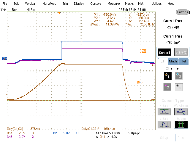

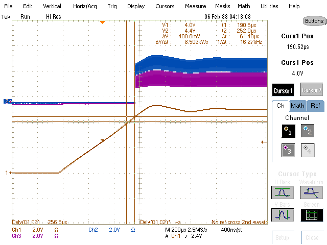

  • Hi Masami,
    Here are  some startup images to show that the startup time is dependent on the ramp rate of your power supply.
    The device starts switching only when Vcc becomes greater than UVVcc which is from 4.2V - 4.4V.
    I hope this helps
    Daniel Noel
