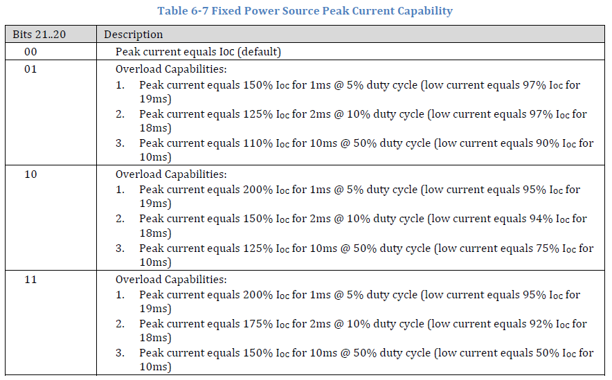

According to "Universal Serial Bus Power Delivery Specification Revision", 2.0, V1.2, each PDOs can have Peak current setting in bit21:22 and the settings are classified by Peak current and its duty as below.

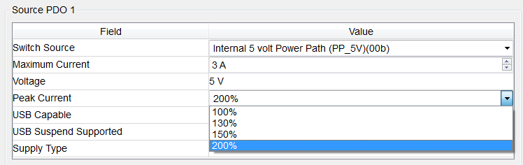

However, it's unclear how the options displayed on App config tool below corresponds to the above table.
Could you clarify which ”%"option we should select to set this peak current setting to "01b"?

    You should select the 130% option for the peak current setting of 01b.

    According to the latest PD specification(v1.3),  it looks that each peak current settings were changed as below.
    Peak Current  Table6-7 (Bits 21…20)
    00b → 100% IOC
    01b → 150% IOC
    10b → 200% IOC
    11b → 200% IOC
    1. Has this point already fixed in the latest TPS6598X FW?
    2. Could you tell me whether there is any issue in PD compliance test  or not? (if it has not supported yet)
    3. If we set higher peak current such as 200% IOC, it seems OCP trip point will move to higher. In this setting, we are afraid that Source can not detect Sink's over current condition between IOC and 200% IOC though, do you have any ideas to detect Sink's over current condition in such case?

    The FW allows four different peak current configuration: 100% ,130% ,150%, 200%. These are hard set limits that are imposed onto the device. Unfortunately, there is no current  FW solution to implement the peak current profiles that you see in the USB PD Spec document.
    For example: Assuming a nominal current of 3A, if you set your peak current  to 150% by selecting it to10b, the maximum current before a fault occurs is 4.5A. There will not be a change of peak current profile as you see in the picture you referenced ( 200%,150%,125%).
    With that said, I just wanted to clarify that the TPS65982 have passed compliance testing for the current platform.
