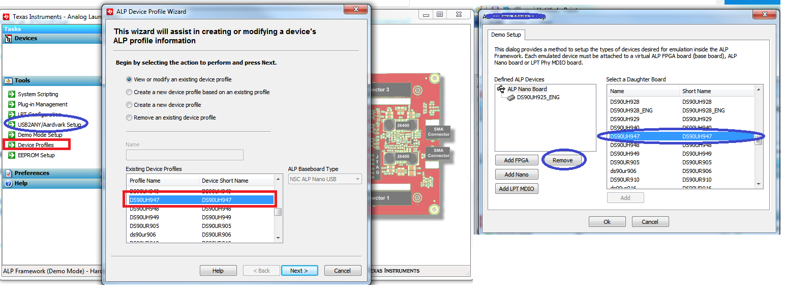

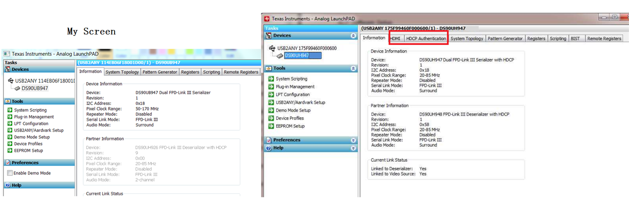

Hi Team:
My ALP software is always DS90UB925. And I check the 947's user guide find that
Could you share the software to me? Please also share the 948. Thanks.

Derek,

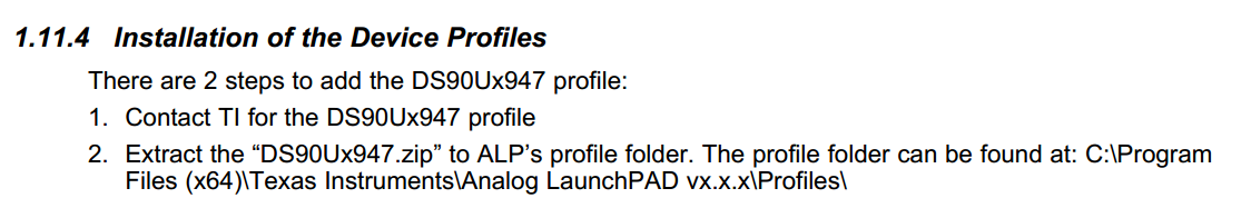

have you checked whether you had UB947 or UH947 scripts in your .../profiles?
1. please make sure you get the last USB to any accompanying with Ux947 EVM;
2. You can reset the hardware "USB to any" please follow up this module's use guideline, you can get it in TI's weblink;
3. I had send the files to you in one separately if you still can not make EVM work with above solutions.
best regards,Steveb
