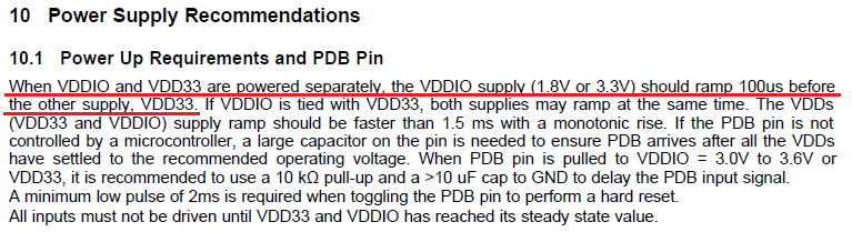

I have two questions about Power Up Requirements of DS90UB928Q-Q1.
(datasheet page 58)
1)
I believe VDDIO supply ramps more than 100us before VDD33 is no ploblem.
Is my understanding correct?
Or should I set "100us" exactly?

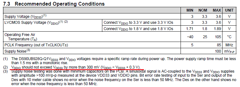

2)
Recommended condition shows "VDDIO < VDD33 + 0.3V".
Is it no ploblem to be "VDDIO > VDD33 + 0.3V" as long as during power up sequence?
(datasheet page 7)
