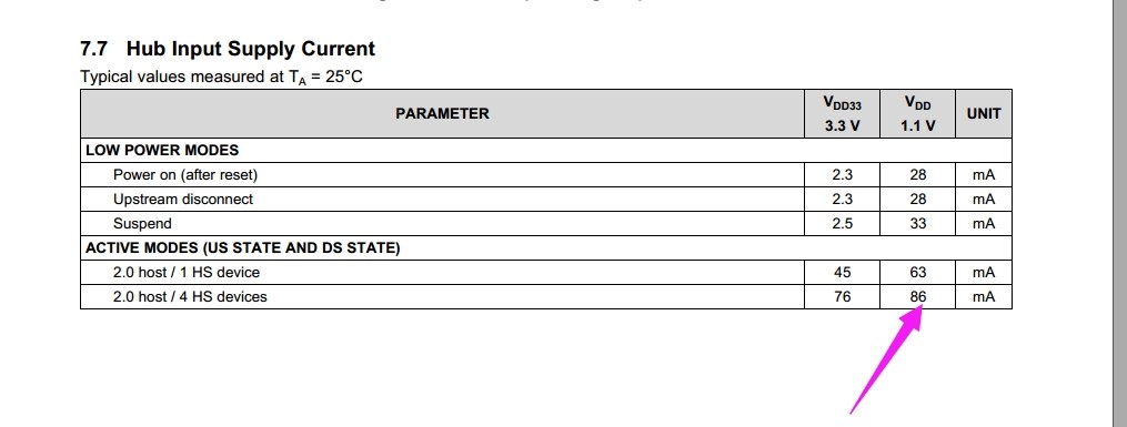

From datasheet the VDD of Hub Inpurt Supply Current is 86 mA.

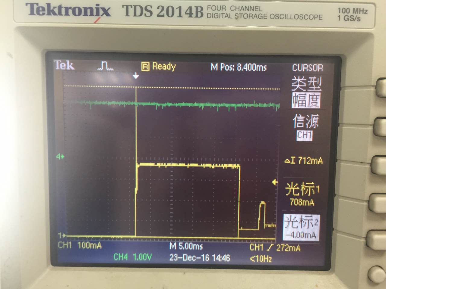

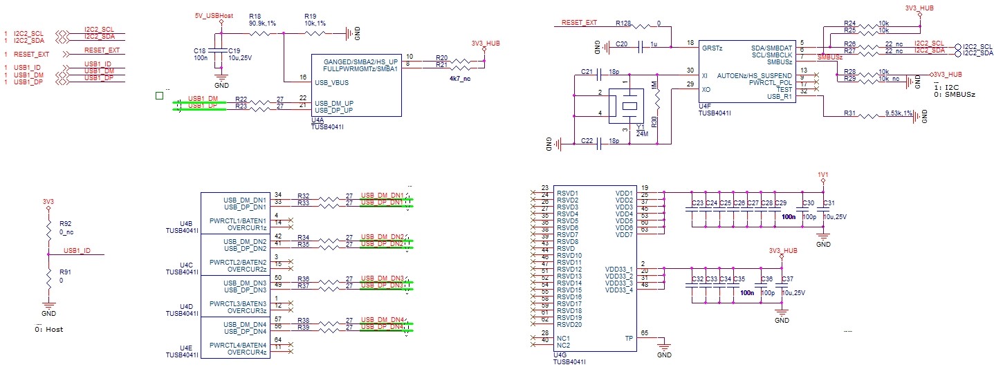

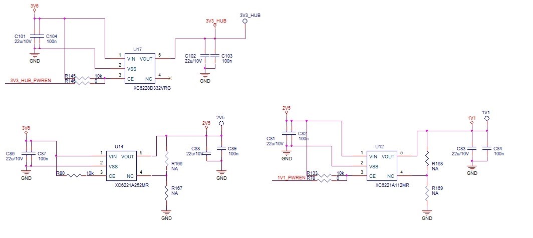

However, the test result is so higher than the data of datasheet, pls. see the below pictures.
Pls. give some advice about the issue, thanks!
