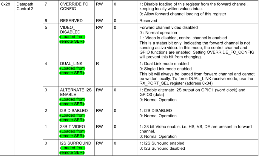

According to datasheet of DS90UH948, "Loaded from remote SER" is decribed in Add 0x28[5:0].
And I confirmed whether these bitfields are changed by using DS90UH949 when bitfield of "override fc config" is "0".
Then, I observed following result.
1. When I write 0x7F to DS90UH949, I observed 0x69 (I expected that 0x3F can be observed in Add 0x28 of DS90UH948).
2. When I write 0x7F to DS90UH949, I observed 0x20 (I expected that 0x00 can be observed in Add 0x28 of DS90UH948).
According to above result, following bitfields are not loaded from SER even though I set Add 0x28[7] of DS90UH948 to 0x0.
* 0x28[5] VIDEO_DISABLED
* 0x28[4] DUAL_LINK
* 0x28[2] I2S DISABLED
* 0x28[1] 28BIT VIDEO
So, Could you please send me correct information about which bitfield of Add 0x28 is loaded from SER when Add 0x28[7] is 0x0 ?

    1. When I write 0x7F to Add 0x1A of DS90UH949, I observed 0x69 (I expected that 0x3F can be observed in Add 0x28 of DS90UH948).
    2. When I write 0x00 to Add 0x1A of DS90UH949, I observed 0x20 (I expected that 0x00 can be observed in Add 0x28 of DS90UH948).

    I'm confused about what you're trying to do. Register 0x1A on the 949 only has three bits which are not reserved. The other 5 bits should not be set to 1.

     >Register 0x1A on the 949 only has three bits which are not reserved.
    Yes, you are correct. However, according to datasheet of UH948, it seems that Add 0x28[5:0] value comes from SER register.
    So, I would like you to confirm which bitfields are loaded from SER to UH948 in fact.
    (From my experment which I used DS90UH949, at least, bit [5:4] and bit [2:1] of Add 0x28 of UH948 were not loaded from SER register value.)
    Machida
  • Bits [5:4] and [2] are loaded from the serializer but not necessarily from a specific register. It is just based on what the serializer is sending - whether video is sent, if it is single/dual, and whether I2S is present.
    Bit [1] should be loaded from 0x1A like you say, I will have to look into why this is not the case.
    Jason

    >Bits [5:4] and [2] are loaded from the serializer but not necessarily from a specific register. It is just based on what the serializer is sending - >whether video is sent, if it is single/dual, and whether I2S is present.
    I understood that Bits [5:4] and [2] of UH948 indicate information of forward channel (not register infomation).
    In fact, Register information of SER is loaded only Bit[3] and Bits[1:0] to UH948, right ?
    Is there any information about why this bit is NOT loaded from SER register ?
