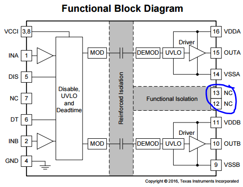

Is it possible to completely remove pins 12 and 13 from the package of the UCC21520 to create even more room for functional isolation between the A and B VDDs, OUTs, and VSSs?

Thanks very much for your interest. Yes, it is possible. However, we don't have this part right now.
Could you please tell me the application? and how much clearance distance you need to apply for your application? which safety code are you using? Thanks so much.
