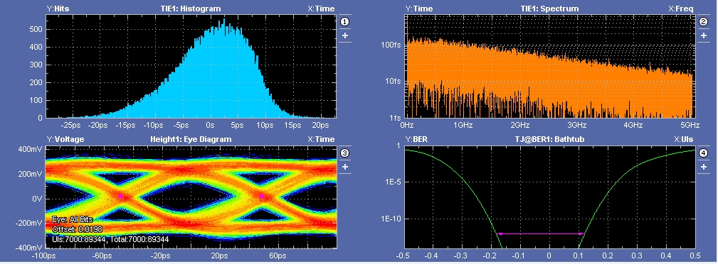

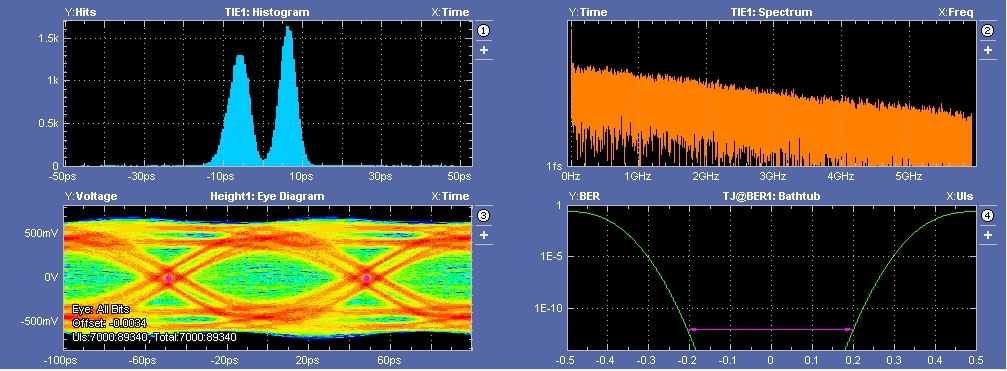

    We are using  Retimer DS125DF410 as the SerDes repeater.  Now a small part of packets are lost in 10G serdes application. Please refer to the detailed design as below:
DS125DF410 is between SFP+ and Ethernet SWITCH IC flowing from SFP+ to Switch IC.
It includes three connectors and about 4500mil to 6500mil in length from SFP+ to Retimer DS125DF410.
Eye diagram is good before DS125DF410 and become very poor after DS125DF410 treatment.  Attached photo is as below.
We  guess that DS125DF410 output will become poor if Equalizer configured too high meanwhile the input signal quality is good. Is that possible?
So would you please advise recommended registers configuration value according to this case? or give us some advice? thanks very much!
The eye diagram before DS125DF410
The eye diagram After DS125DF410 become poor
  • Hi Leo,
    Please include a register dump of the ds125df410 registers.  This will help to better understand the issue you are seeing.
    Lee
  • Hi Lee,
    Thanks for your support. please refer to the register dump of DS125DF410 as below.
