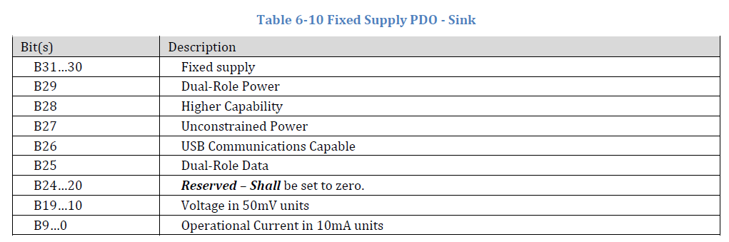

My customer would like to know how to decode 0x35 and 0x36 because explanations in the table are unclear. Can we fully refer to the table indicated in PD spec below?
In addition to this, Could you follow the opening thread below as well?
Takashi Onawa
  • Hi Onawa-san,
    You can use the tables reference in the PD 2.0 specs (found on the USB-IF site).
    For 0x35 and 0x36 you may use Table 6-13 as reference. Table 6-10 is not used for register 0x35 or 0x36 since it is used to define PDOs.
