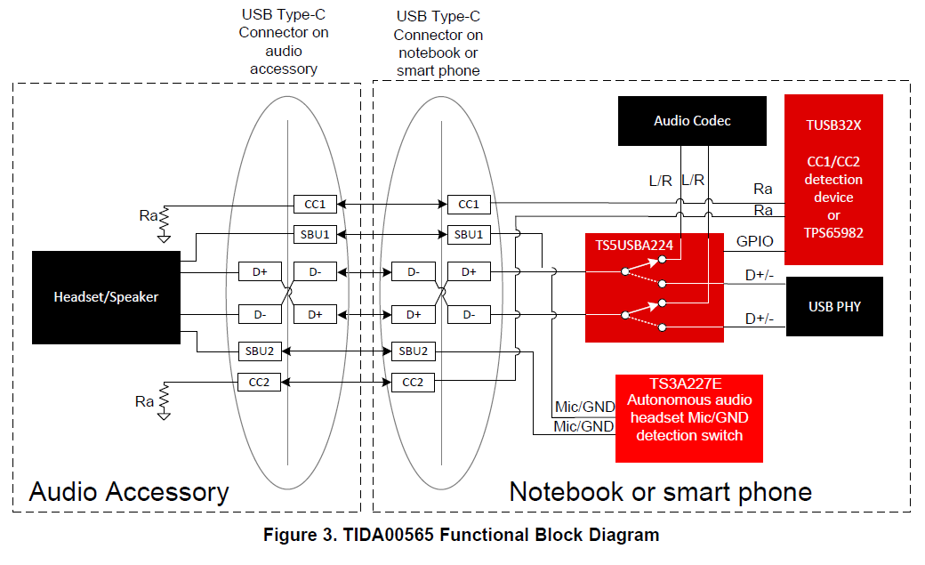

    The TPS6598x devices sense the CC1/CC2 lines in order to detect if an audio device is plugged in its Type-C port. This is done by pulling down on both CC lines through Ra.
    The TIDA POS can be found in the link below which might be helpful. The block diagram from this POS shows how the audio device detection for the TPS6598x works by detecting the CC lines Ra pulldown resistor on the device side. The TS5USUA224 is there to allow the negative swinging analog audio to be passed with no damage to the PHY by MUXing the correct connections according to whats connected to the Type-C port. When the TPS6598x device sees CC1/CC2 have Ra it can toggle one of its GPIOs as a MUX control for the TS5USUA224 to select the correct audio path.
    Jeff

    thanks for your fast reply. As far as I have understood right, your suggestion is about analog audio over USB-C, but this is not what I want to do. I want the TPS65981 to function as my PMM for my intended USB audio device (soundbar). But everything stays digital until I use the TAS576xM as the audio amplifier for my loudspeakers. So generally my soundbar will be plugged in via USB-C . After the power role is negotiated I know how much power I can use and program the amplifier accordignly. The USB audio device is managed via a microcontroller that suits the USB Device Class Definition for Audio Devices Rev. 1.0 . So the flow would be plug in the USB-C --> a new audio device will be recognized in my OS and then I can play audio over my soundbar---> I am happy then :)
