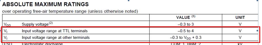

The input voltage range are defined on the datasheet as the following.
Which pins are the TTL terminal?

Hi Koji,
The inputs that supports TTL leves are indicated in datasheet (PIN FUNCTIONS), basically if the pin description does not have an specific label (i.e.PECL) it means the input supports TTLS voltage levels.
